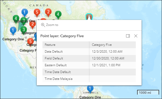

  1. Click Publish.
The image below shows the feature information displayed in the pop-up window on the map when hovering over the feature.
The information displayed when hovering over the feature on the map.

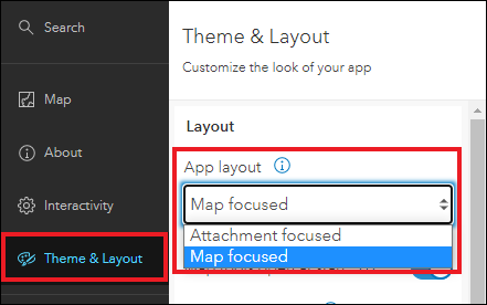

  4. On the side panel, click Theme & Layout.
  5. Under App layout, click the drop-down list, and select Map focused.
The Map focused layout, showing the map is displayed in the main stage with the attachments and pop-up contents on the info panel.

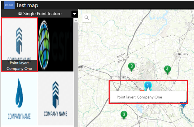

  2. Enable the Feature label option to display feature information in a label on the map when hovering over an attachment on the info panel.
The Feature label displaying the feature information on the map when hovering over an attachment on the info panel.
  1. Click Publish.
Note:
Refer to Step 4 of this documentation to configure the pop-up title of the layer in Map Viewer to display the intended information in the hover feature label in the Attachment Viewer configurable app.
In Map Viewer, configure the layer's pop-up title to display the intended information in the hover feature label in the Attachment Viewer configurable app.
The image below shows the feature label displayed on the map when hovering over its attachment on the info panel.
The pop-up displaying information when hovering over an attachment on the info panel.
