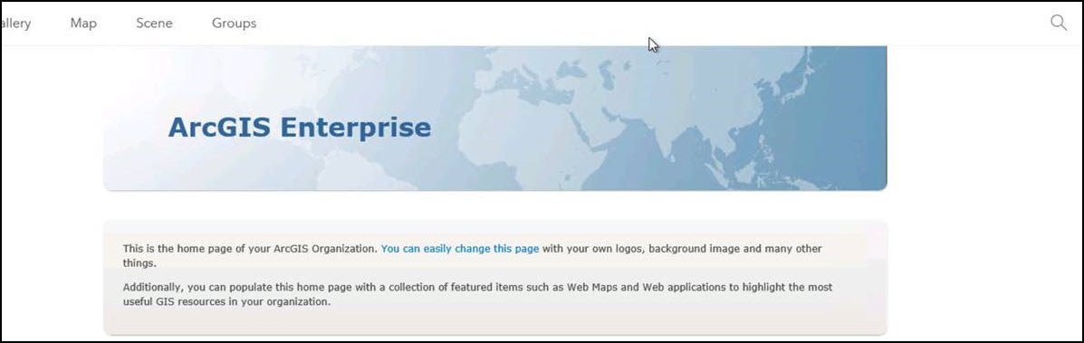

In some instances, when attempting to log in to Portal for ArcGIS configured with Integrated Windows Authentication (IWA), the Sign In option is not available on the portal's home page, as shown in the image below.
The user account is not a member of the portal.
