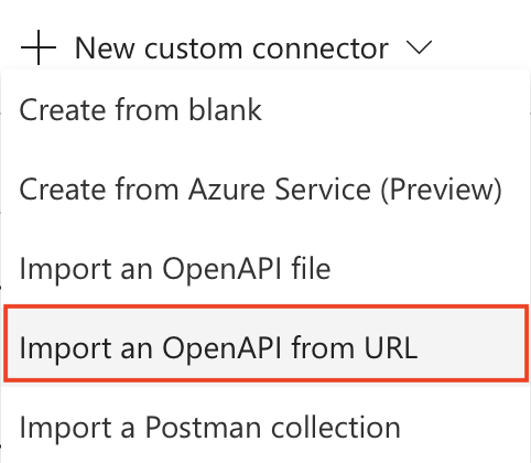

- Click the New custom connector drop-down at the top right and select Import an OpenAPI from URL.

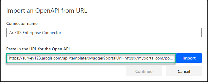

- In the Import an OpenAPI from URL dialog box, complete the following:
In the example below, <ENTERPRISE_URL> is the URL to your ArcGIS Enterprise deployment, including the web adaptor, for example, https://myserver.mycompany.com/arcgis.
https://survey123.arcgis.com/api/template/swagger?portalUrl=<ENTERPRISE_URL>
- Connector Name: ArcGIS Enterprise Connector (this can be whatever you want to call it).
- Paste in the URL for the Open API, and click Import.
- After the API has been imported, click Continue.

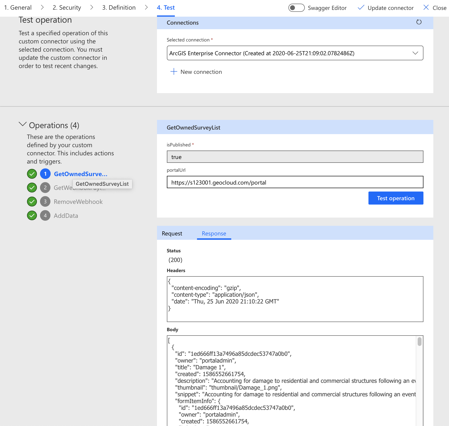

- Return to the Power Automate tab. Click the 5. Test link at the top. Create a new connection - you should be prompted to sign in to ArcGIS Enterprise in a pop-up window. Once a connection has been created, you can test the webhook functions:
- GetOwnedSurveysList - Returns a list of your surveys. Select a survey and copy its id for use in subsequent steps.
- Get WebhookPayload - Returns a payload definition that can be used by Power Automate to automatically present values like the feature's fields in other steps of a flow. Requires a survey id.
- AddData (NOTE: this is out of order from the screen) - Registers a webhook with a form. Requires a survey id and destination URL (can be a test URL like https://localhost). The events that will trigger the webhook (addData|editData|addData,editData) also need to be specified. The results contain a unique id that will be used in the RemoveWebhook step.
- RemoveWebhook (NOTE: this is out of order from the screen) - Removes a given webhook from the form. Requires a survey id and webhook id from the AddData step.
