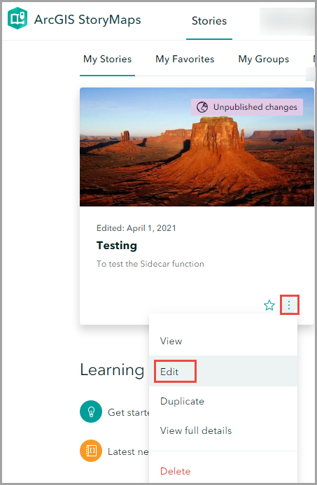

  1. In ArcGIS StoryMaps, navigate to the story map containing the sidecar and embedded maps, click the Quick actions button, and click Edit.
The ArcGIS StoryMaps window.

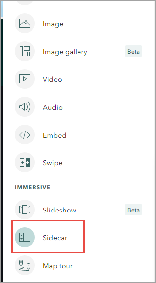

  1. Click the Add content block button, and select Sidecar.
The new content block to include in the story map.

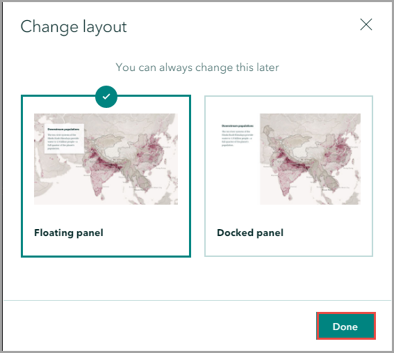

  1. In the Change layout window, select the panel layout, and click Done.
The Change layout window with the two different types of sidecar layout panels.

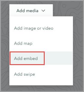

  1. In the media panel of the first sidecar slide, click Add media, and select Add embed.
The media panel of the first sidecar slide.

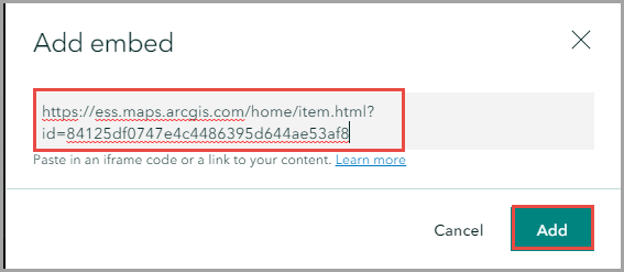

  1. In the Add embed window, paste the link of the web map, and click Add.
The Add embed window.

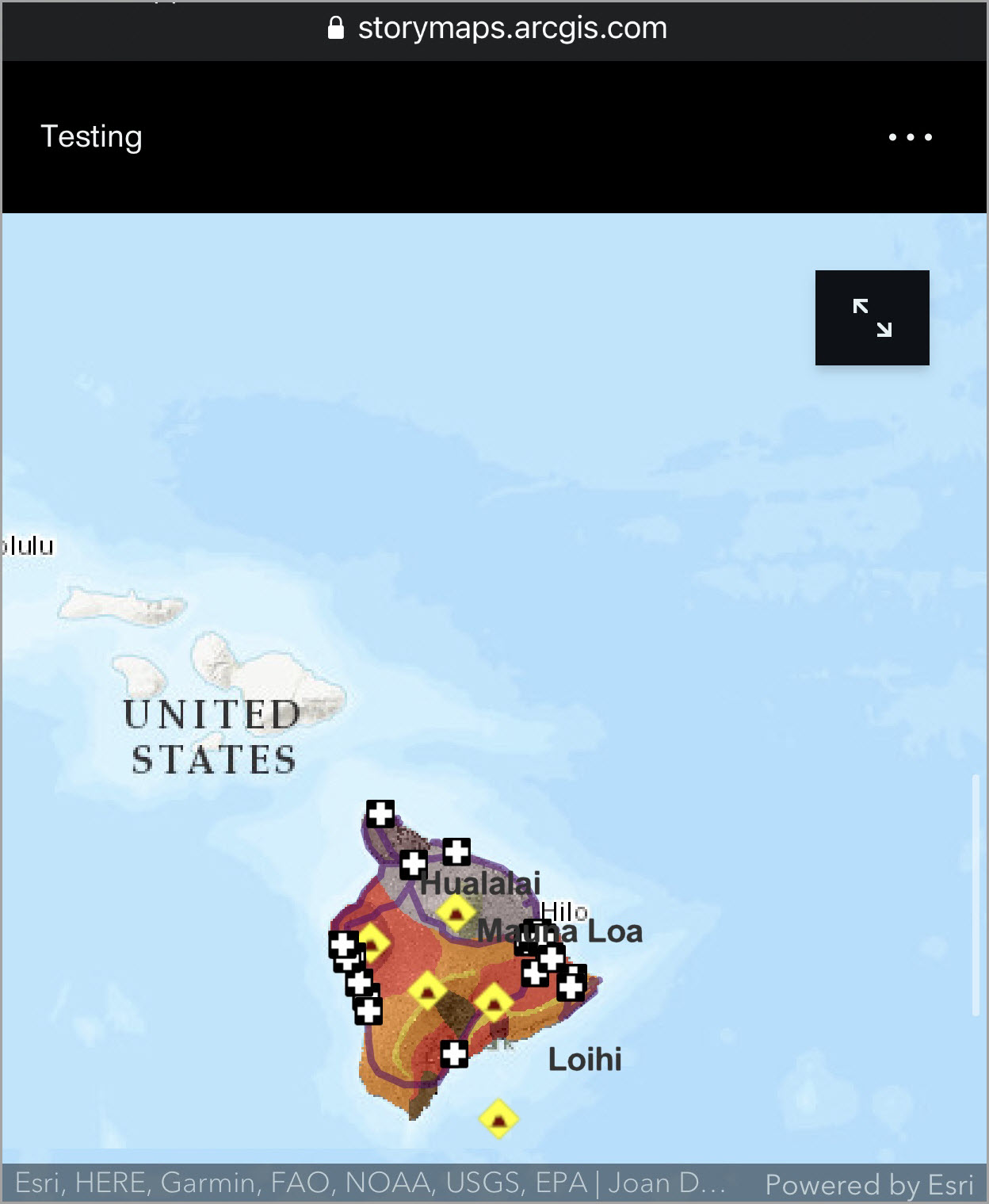

The following image demonstrates the embedded map loaded successfully on the iOS device.
The web browser of the iOS device showing the  embedded map successfully loaded.
