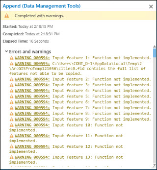

Data from an ArcGIS Pro feature class can be appended to an ArcGIS Online hosted feature layer using the ArcGIS Pro Append tool. In some instances, attempting to append data to a hosted feature layer fails, and returns the warning message, 'WARNING 000594: Input feature <FeatureID>: Function not implemented.'
Image of the warning message.

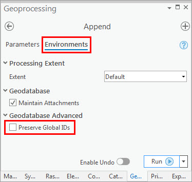

    1. On the Parameters tab, select the layers for Input Dataset and Target Dataset.
    2. On the Environments tab, uncheck the Preserve Global IDs check box.
    3. Click Run.
Image of the Environments tab.
The data from the feature class is successfully appended to the hosted feature layer without warning messages returned.
