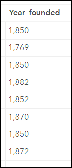

The image below shows the values in the Year_founded field with a thousand separator (comma).
Image showing the Year_founded field values with comma.
This article provides two options to remove the thousand separator (comma) from a Year_founded field (numeric field).

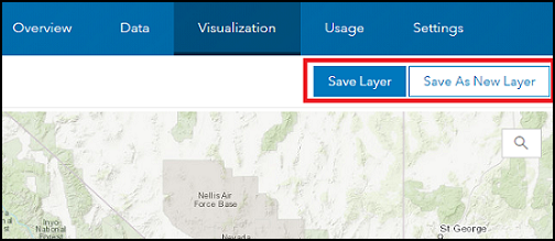

  1. On the top-right section, click Save Layer to save the edits in the existing layer, or click Save As New Layer to save the layer as a new layer.
Image showing the the two save options for the hosted feature layer in the Visualization tab.

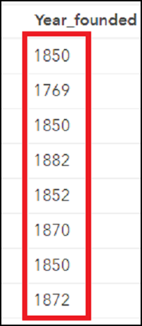

The image below shows the Year_founded field without the thousand separator.
Image showing the field displayed without the comma.
