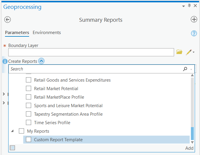

Once all these items are in place, open ArcGIS Pro and the report template will be available in the My Reports section of the Summary Reports geoprocessing tool. The report template will be displayed in the My Reports section of the Business Analyst Tools > Reports > Summary Reports tool, as shown in the image below.
