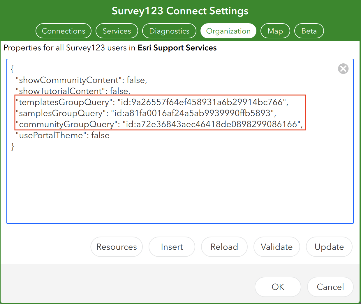

- Populates the ArcGIS Survey123 Organization properties using the appropriate groupIDs, for example:
"templatesGroupQuery": "id:9a26557f64ef4584931a6b28814bc766" "samplesGroupQuery": "id:a81fa0016af24a5ab9939990ffb589f3" "esriTemplatesConnectGroupQuery": "id:738029d818674f45b9d91aee70e92d58", "esriTemplatesWebsiteGroupQuery": "id:2af4f1919ef54f40abf898c8a0487b99", "communityTemplatesConnectGroupQuery": "id:d345218237c9487484c98dbaf82d3404", "communityTemplatesWebsiteGroupQuery": "id:93e1a6ebb65941368622406015c1e155"

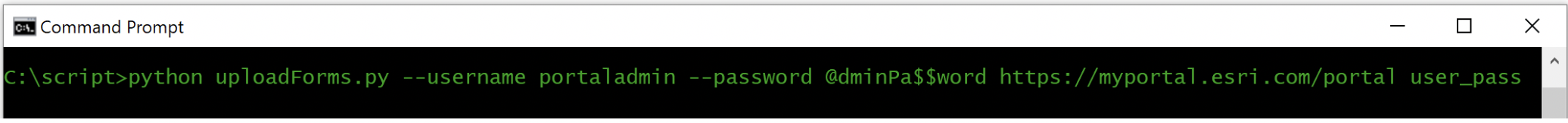

- Enter the appropriate command to run the script depending on the ArcGIS Enterprise portal’s authentication method. The following is a basic format of the command to run the script:
Note: The account used to run this script is the owner of the uploaded forms. This means the uploaded content are displayed in the ArcGIS Survey123 Connect gallery of that account. Given the large number of forms, Esri recommends running the script from an account that is not used for ArcGIS Survey123 Connect.
python uploadForms.py <portal_url> <auth_method>It is also possible to specify optional parameters if required. Below is the list of <required> and [optional] parameters along with a short explanation for each component:
<portal_url> <auth_method> --folder [folder_name] --username [username] --cert_file [certificate] --password [password] --key_file [key_file] --client_id [client_id]
- portal_url: The portal to upload the forms to.
- auth_method: The authentication method to use with the portal: user_pass, pki, iwa, saml, pro. The last option, pro, uses an active ArcGIS Pro connection in the environment regardless the specified <portal_url> parameter.
- folder: Folder to place the forms in. This is created with a default name of Admin: Survey123 Templates if there is not a specified existing folder.
- username: Username for the user_pass authentication method.
- cert_file: Certificate file for the pki authentication method.
- password: Password for the user_pass or pki authentication method.
- key_file: Certificate key file for the pki authentication method.
- client_id: App ClientID for the saml authentication method.

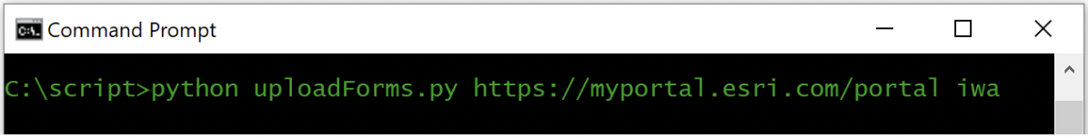

The image below specifies iwa as the authentication method. This method, and pro do not require any additional parameters.
The image below is an example of the command to run the script with the user_pass authentication method which requires additional parameters for the username and password.
- Check the ArcGIS Survey123 Organization properties, and manually make desired changes using the Organization Properties editor included in ArcGIS Survey123 Connect. Refer to the the 'Disable other internet requests' section below for more details.
Note: Use ArcGIS Survey123 Connect 3.10 and above to read the group query Organization Properties, so any new surveys can utilize the locally hosted survey templates and samples in a disconnected environment.

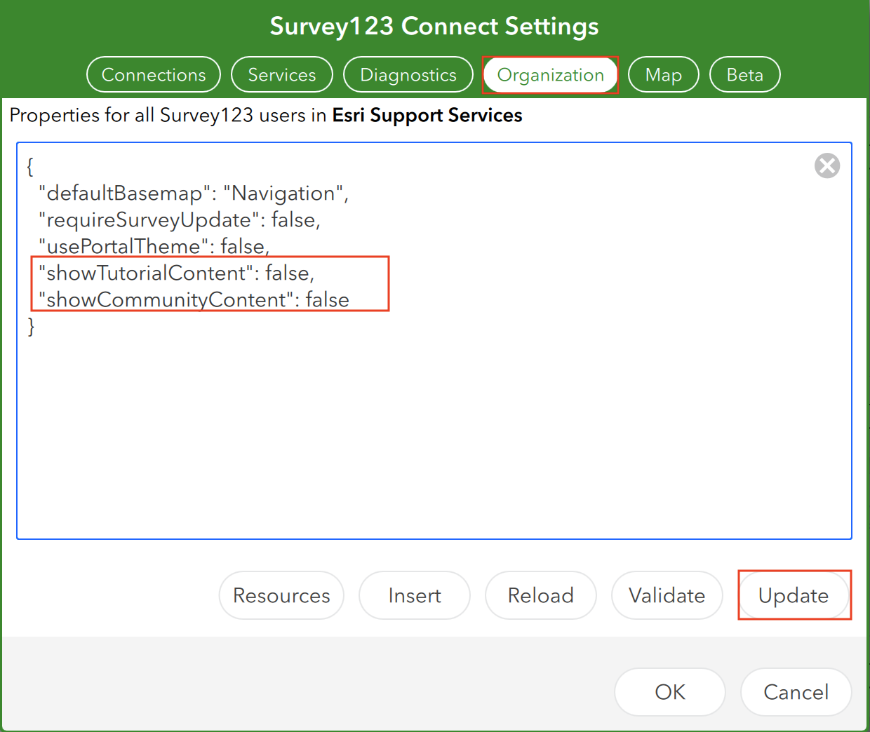

ArcGIS Survey123 Connect makes internet requests to access other content such as tutorial videos, GeoNet and Twitter. These requests can be disabled by setting two ArcGIS Survey123 Organization properties, showTutorialContent and showCommunityContent. These properties are automatically set during the post installation wizard via the question, 'Are you installing the Survey123 website in a disconnected environment with no internet access?' Depending on the ArcGIS Enterprise deployment, a manual post installation may have been necessary which means this setting has not been updated.
Follow the steps below to manually set these properties using the Organization Properties editor included in ArcGIS Survey123 Connect.
- Open ArcGIS Survey123 Connect, and sign in using an account with administrator privileges.
- Click Settings. Click and hold Survey123 Connect Settings for a few seconds. Refer to the short video on this:
Organizational Settings in Survey123 Connect - In the Survey123 Connect Settings window, click Organization. The settings are stored in a JSON-formatted text. Add the following text to disable both the Tutorials and Community content, and associated internet requests.
Note: Properties must be separated with a comma. For example, "showTutorialContent": false, "showCommunityContent": false.
- Click Update. Check if the updates are successful.

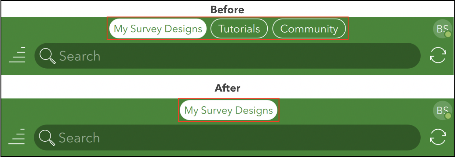

The Tutorials and Community tabs are no longer available in ArcGIS Survey123 Connect.

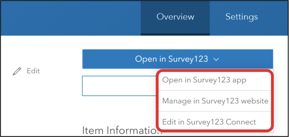

Update the ArcGIS Enterprise portal survey item links
There are three Open in Survey123 links available in ArcGIS Enterprise portal to launch survey content, and these links use https://survey123.arcgis.com by default.

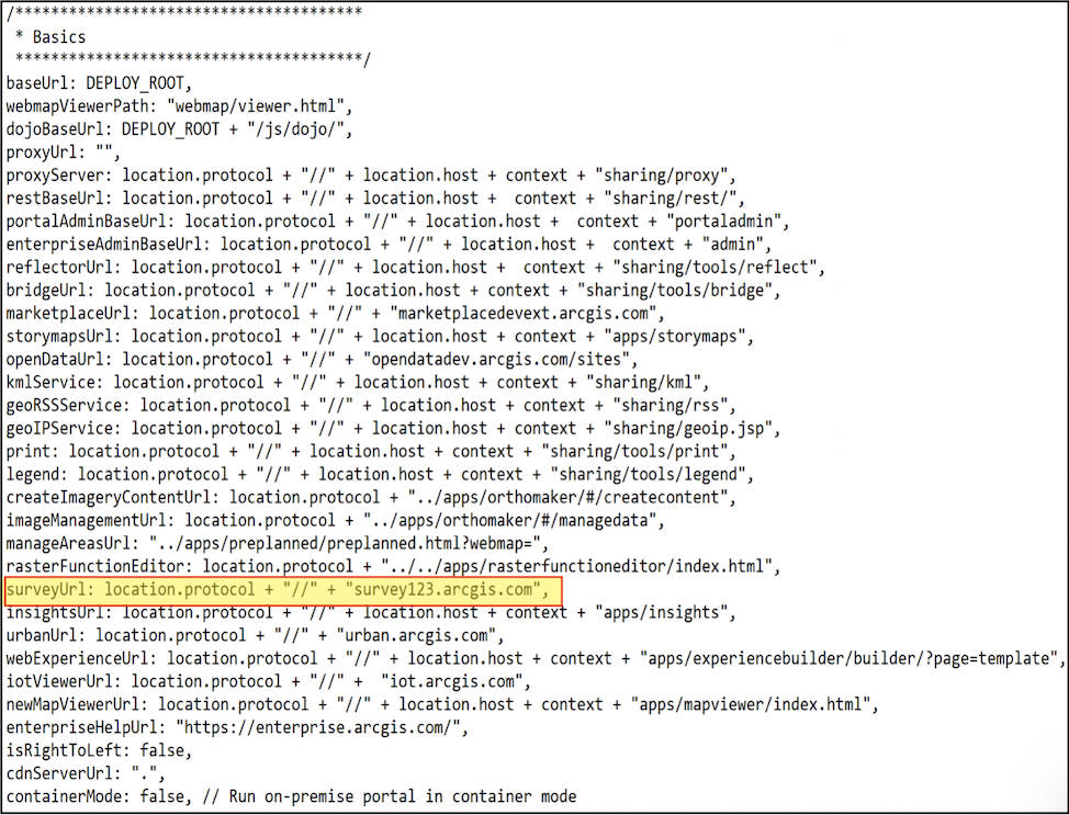

- Log in to the machine hosting Portal for ArcGIS.
- Navigate to the portal's installation folder. By default, this is C:\Program Files\ArcGIS\Portal.
- Locate the GeoConfig object in ~\ArcGIS\Portal\customizations\<VERSION NUMBER>\framework\webapps\arcgis#home\js\arcgisonline\config.js.
- Run a text editor as an administrator, and open the config.js file.
- In the config.js file, search for surveyUrl (this has been present since Portal for ArcGIS 10.7.1) and substitute survey123.arcgis.com with the installed ArcGIS Survey123 website host URL. This is the URL used to access the installed ArcGIS Survey123 website including any port numbers, or reverse proxy access point if there is one configured.
- Save the config.js file.
- Restart Portal for ArcGIS Windows service for the changes to take effect.
Ensure the Open in Survey123 app, Manage in Survey123 website, and Edit in Survey123 Connect links utilize the installed ArcGIS Survey123 website host URL.
