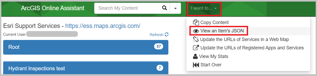

  1. Open ArcGIS Online Assistant, and log in through ArcGIS Online or Portal for ArcGIS.
  2. Click the I want to... drop-down list, and select View an Item's JSON.
Image of theI want to... drop-down list

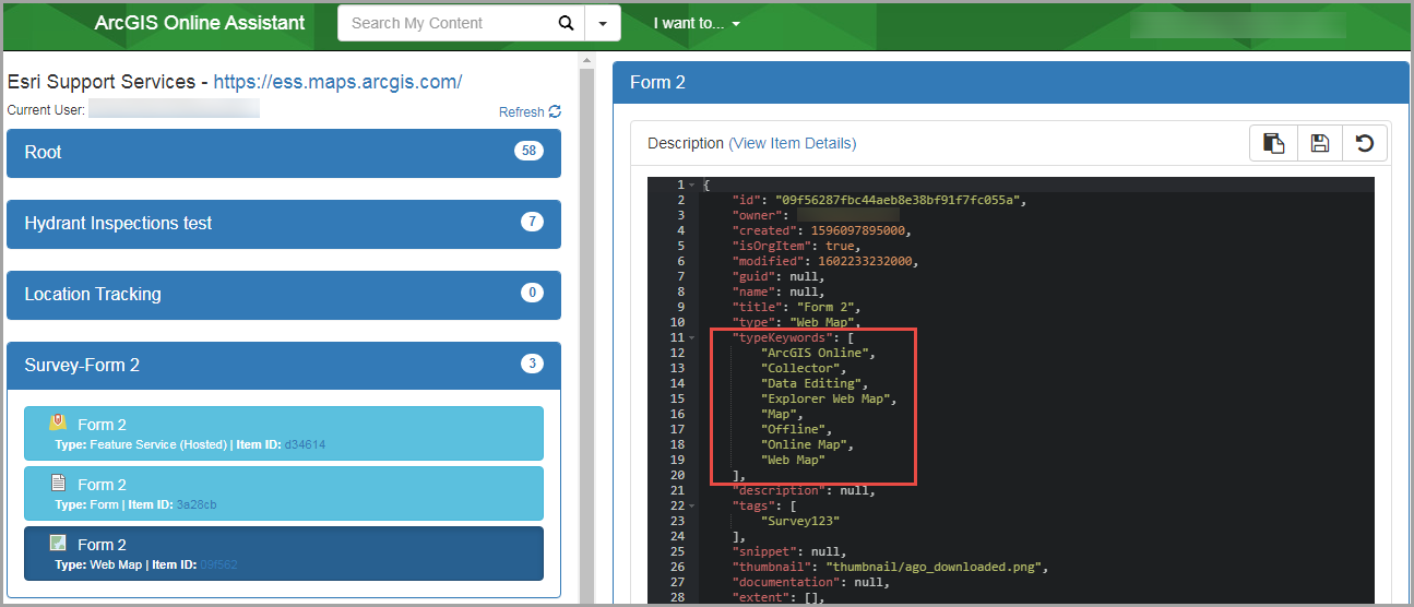

  1. Select the desired web map to view the Description window for the scripting.
  2. Click the Edit JSON icon, and add Collector and Data Editing in the typeKeywords parameter, as shown below. Click the Save icon.
"typeKeywords": [
        "Collector",
        "Data Editing",
        "Explorer Web Map",
        "Map",
        "Offline",
        "Online Map",
        "Web Map"
The following image is the example of how the keywords are added in the scripting.
Image of the example of how the keywords are added in the scripting
