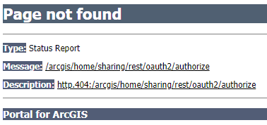

Signing in to Survey123 for ArcGIS via the Portal for ArcGIS app launcher or website returns a 404 error, stating the page is not found.
Image of the error message
