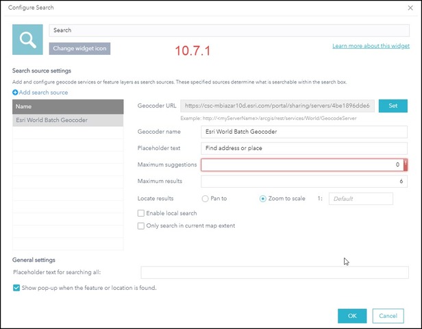

  1. When configuring the Web AppBuilder, on the Search widget, click the Configure this widget Image of the Configure this widget button. button.
  2. In the Configure Search window, enter 0 for Maximum suggestions.
configuring the widget in 10.7.1 shows an error

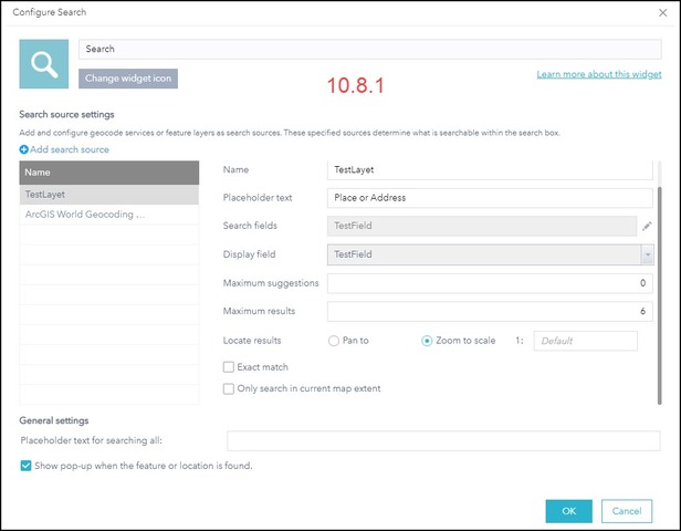

configuring the widget in 10.8.1 is successful
  1. Set other parameters as desired, and click OK to save the configurations.
