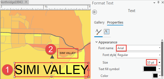

In ArcGIS Pro, the text and annotation sizes are different when viewed in the same map scale even though the same type of font and size are used.
The following image shows the text size (1) is displayed larger than the annotation size (2).
  The text size is larger than the annotation size
Cause
The text size is larger because it is not controlled by the map reference scale. Therefore, the text size does not change when the map reference scale changes. However, the difference in the reference scale of the annotation layer and the map scale affects the display of the annotation size in the layout.

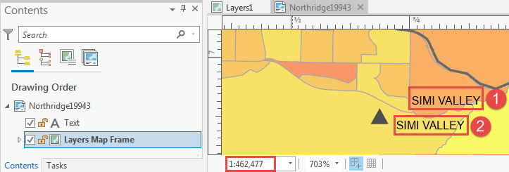

Set the map layer reference scale similarly to the reference scale of the annotation layer
Note:
Ensure the text size is set similarly to the annotation size before proceeding with the steps below.

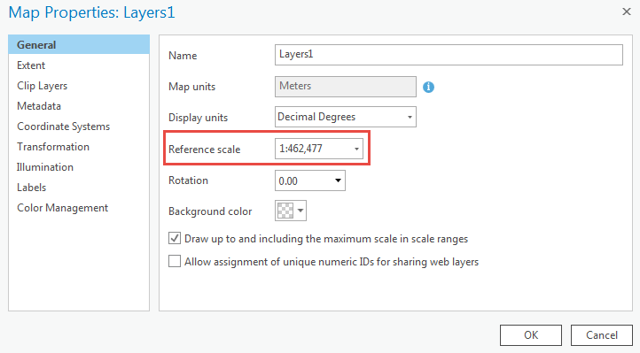

  1. In ArcGIS Pro, right-click the map layer.
  2. Select Properties > General > Reference scale.
Image showing the reference scale of the annotation layer
The following image shows the annotation (1) and text (2) sizes are similar when zooming in or out after the map scale is set to 1:462,477, which is the same as the reference scale of the map layer.
