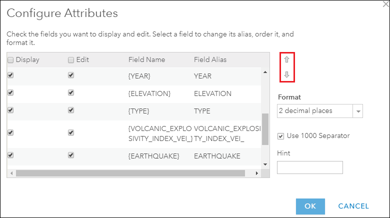

  3. Click Configure Pop-Up > Configure Attributes.
  4. In the Configure Attributes dialog box, select the desired attribute to reorder, and click either Move up or Move down. Reorder the attributes according to the desired order. Click OK.
The Configure Attributes icon.

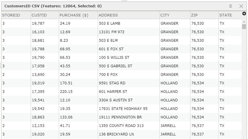

The table below shows the initial and final attributes display, before and after the attributes are reordered for this example.
BeforeAfter
ADDRESSSTOREID
CITYCUSTID
STATEPURCHASE ($)
ZIPADDRESS
PURCHASE ($)CITY
CUSTIDZIP
STOREIDSTATE
  1. In the Configure Pop-up pane, click OK.
The reordered attributes.

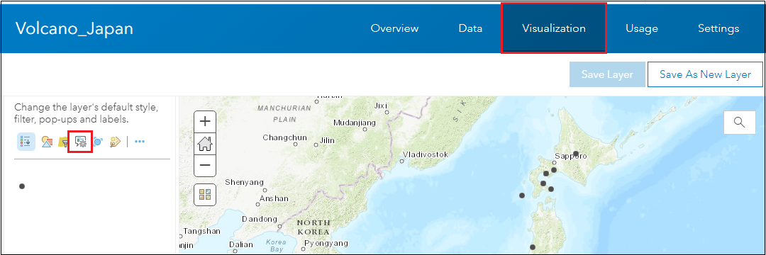

  1. Save the map.
Note:
For feature layers or hosted feature layers, click More Options > Save Layer. This saves the changes to the layer. Skipping this step does not retain the changes made when the feature layer is opened in Map Viewer Classic in a different session.
