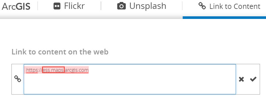

Original URL: https://[short organization name].arcgis.com/
Image of a URL with the short URL of the owner's organization

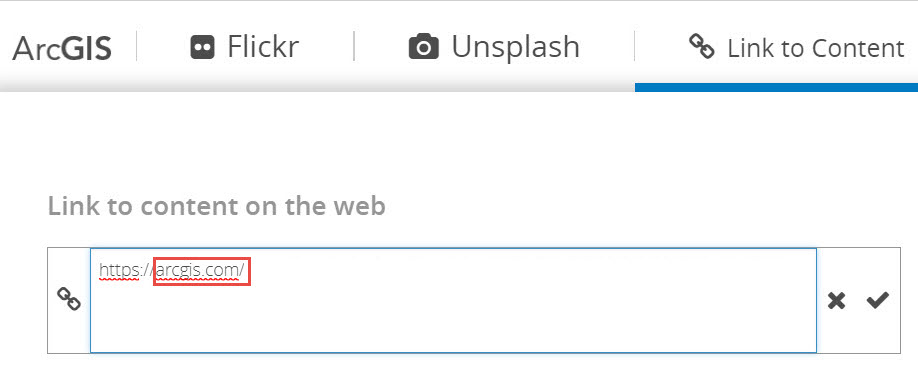

Updated URL: https://arcgis.com/
URL with the organization's short URL removed in ArcGIS StoryMaps
