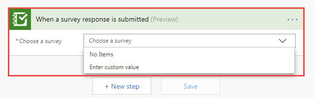

Microsoft Power Automate can be used to automate email notifications when responses are submitted from ArcGIS Survey123. In some instances, when attempting to select a survey in the 'When a survey response is submitted' trigger, the drop-down list does not display any surveys.
The drop-down list of surveys without any surveys

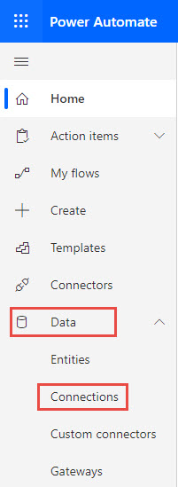

  1. Sign in to Microsoft Power Automate.
  2. Navigate to Data > Connections.
Image showing the Power Automate data connections pane

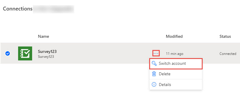

  1. Click the Survey123 ellipsis, and select Switch account.
Image showing the Switch account option

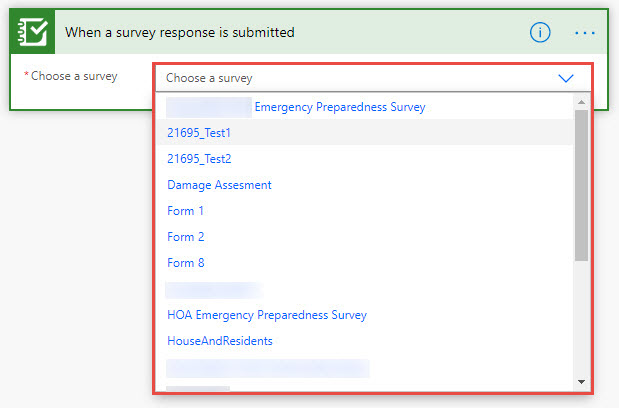

The existing surveys are available in the drop-down list after signing in to ArcGIS Online.
Image showing the list of surveys
