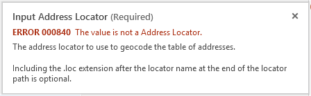

Error: Input Address Locator (Required). ERROR 000840 The value is not a Address Locator
Error Message
Business Analyst Data for Desktop comes with locator files for ArcMap and ArcGIS Pro. The folder ....Business Analyst\US_2018\Data\Geocoding Data for ArcGIS Pro contains a USA.loc file that can be used in ArcGIS Pro to geocode addresses. Some users may run into the following error when using this .loc file.
ERROR 000840 The value is not a Address Locator.
The address locator to use to geocode the table of addresses.
Including the .loc extension after the locator name at the end of the locator path is optional.
