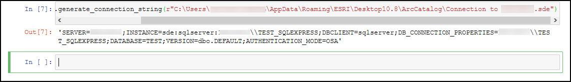

  1. Create a connection string for the database to be updated using the generate_connection_string() method. The code generates a connection string to be used when creating a new data item.
server1.datastores.generate_connection_string(r"C:\Users\user\AppData\Roaming\ESRI\Desktop10.x\ArcCatalog\Sample.sde")
The sample image of the connection string.
