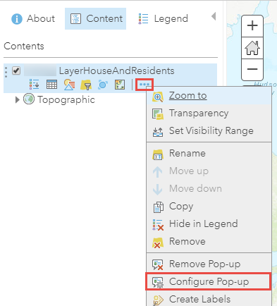

  2. In the Contents pane, navigate to the desired feature layer, click the More Options ellipsis Ellipsis icon, and select Configure Pop-up.
Configure Pop-up option

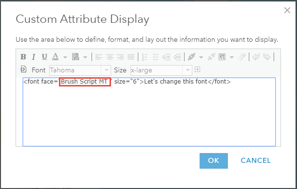

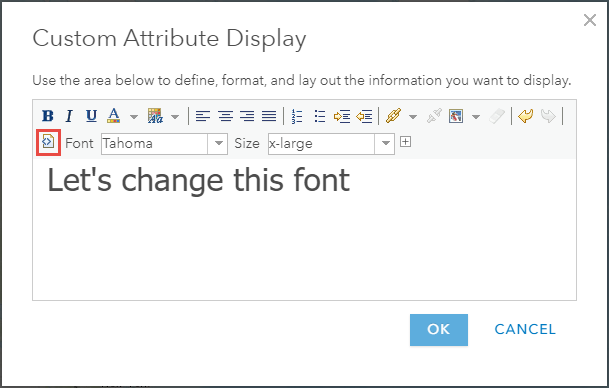

  1. In the Custom Attribute Display window, type the desired text, and click the View HTML Source icon to view the HTML codes. In this example, the default font is Tahoma.
Custom Attribute Display box
HTML codes
  1. Change the default font with a desired custom font such as Brush Script MT in the source code.

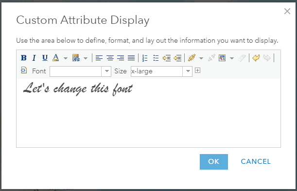

Custom Attribute Display dialog box
  1. Click the View HTML Source icon to view texts with the specified custom font, and click OK to close the dialog box.

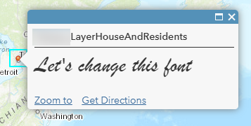

The image below shows text in the Brush Script MT font in an ArcGIS Online pop-up.
