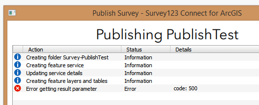

Attempting to publish surveys from ArcGIS Survey123 Connect or ArcGIS Survey123 to Portal for ArcGIS returns the following error messages:
Error:
Dataset not found. Status: Error. Details: code 500
Error:
Error getting result parameter. Status: Error. Details: code 500
Error:
Unable to create a new survey. ERROR: Dataset not found.
​​​​​The error message in ArcGIS Survey123

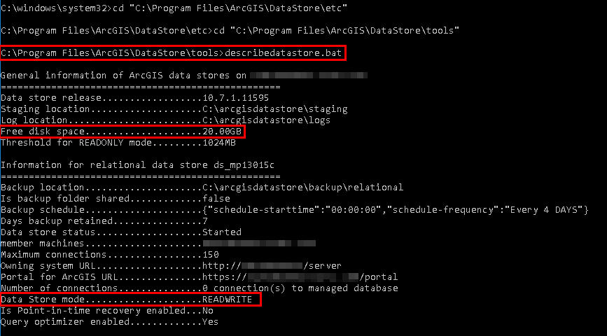

    1. Run the describedatastore.bat utility. Refer to ArcGIS Enterprise: ArcGIS Data Store command utility reference for more information on ArcGIS Data Store command utility references.
    2. Check the Data Store mode, and Free disk space. If the Data Store mode is set to READONLY and there is available disk space, use the following command to set the relational data store to READWRITE.
changedatastoremode readonly|readwrite [--prompt <yes|no>]
Note:
The Data Store mode is automatically set to READONLY when disk-space on the machine is low, to prevent data loss.
  1. Restart the ArcGIS Data Store service in Windows.
The Command Prompt for describedatastore.bat
