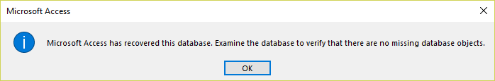

- Click OK in the dialog, and the following message appears:
Microsoft Access has recovered this database. Examine the database to verify that there are no missing database objects.
- Save the style file with a new name, maintaining the .Style extension for the file.
The new copy of the style file will import into ArcGIS Pro without errors. The repaired copy of the style file will also work again in ArcMap.
