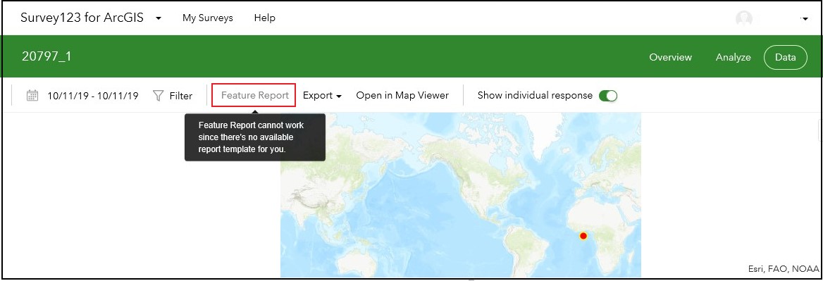

In some cases, the 'Feature Report' option is also disabled. The image below shows the Data tab of a non-owner in Survey123 for ArcGIS.
Data tab of a non-owner of a survey

  • The 'Feature Report' option is disabled because there is no available template created by the owner of the survey.
