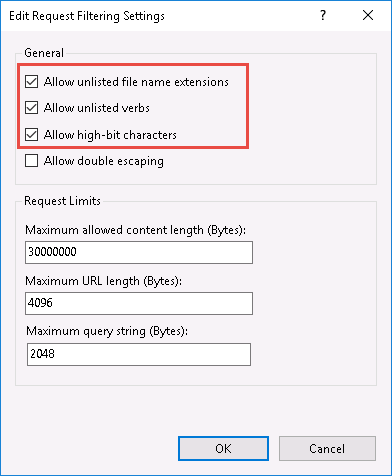

Error: HTTP Error 404.7 - Not Found. The request filtering module is configured to deny the file extension.
File extension filter settings are found within Internet Information Services (IIS) Manager.
Portal for ArcGIS and its underlying processes use many custom file extensions. Access to these file extensions is limited when the 'Allow unlisted file name extensions', 'Allow unlisted verbs', and 'Allow high-bit characters' options are disabled in the Request Filtering section of IIS Manager. Group policy dictates the enabled/disabled settings in IIS Manager, and they may be disabled for security purposes.
Follow the steps below to resolve the issue:
