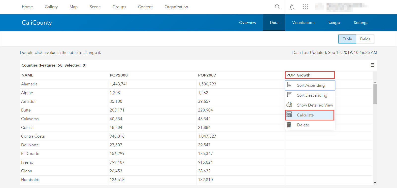

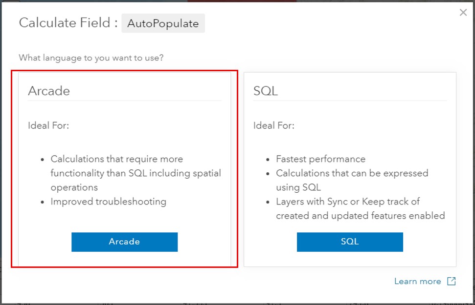

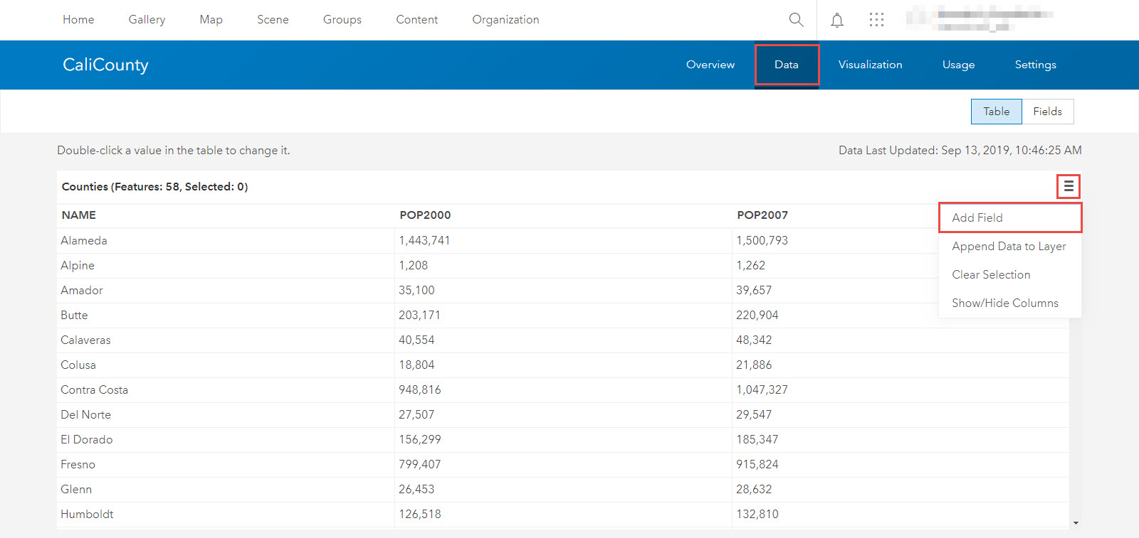

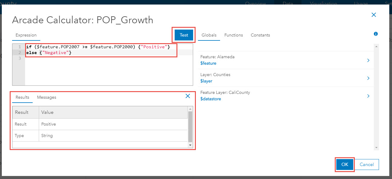

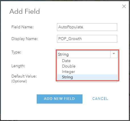

The following instructions describe how to populate a new field with trend status using Arcade expressions in ArcGIS Online. In this article, the new field is populated with the trend status of population growth between the years 2000 and 2007.
Note: The table view can also be accessed from Map Viewer. Click Overview > Open in Map Viewer on the item description page. In Map Viewer, click Content. Hover over the feature layer and click Show Table.
if ($feature.POP2007 >= $feature.POP2000) {"Positive"} else {"Negative"}

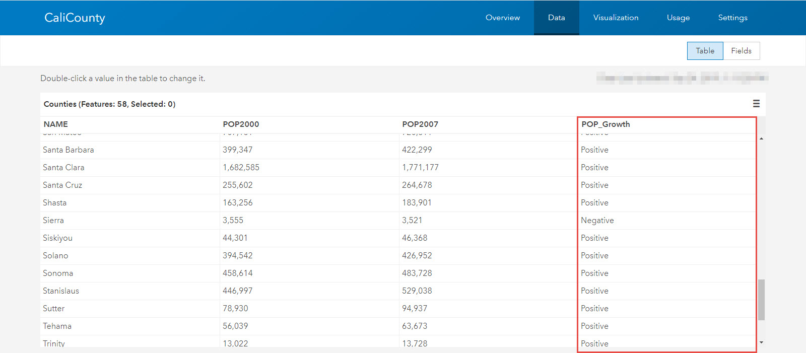

The image below shows an example of the output in the POP_Growth field.
