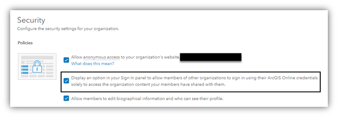

If you have a Map Series and Map Journal application that contains other ArcGIS applications like Viewer, Operations Dashboard and Insights pages, you can now display them to your readers with the help of a few adjustments. This defect was fixed in the June 2019 release of ArcGIS Online with the help of a new security policy setting, as follows:
  • Display an option in your Sign In panel to allow members of other organizations to sign in using their ArcGIS Online credentials solely to access the organization content your members have shared with them — Keep this box checked to allow members of other ArcGIS Online organizations to access items shared with them by members of your organization. When this box is checked, a separate sign in link for members of other organizations is displayed at the bottom of the sign in window for users signing in through the ArcGIS Online website. Members of other organizations can use this link to sign in to your organization with their own organizational account credentials, and access only the items that have been shared with them.
  1. Enable this policy setting in Security settings in ArcGIS Online.

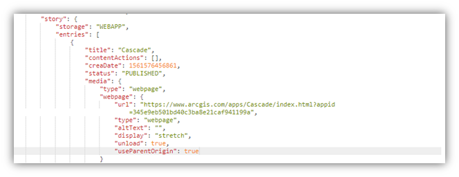

  1. Scroll to the Map Series and Journal in the JSON to find entries and media of type webpage. An example is shown in the following image:
  1. This map series contains a dashboard in one of the tabs. Press Enter and add the following line to the JSON:
“useParentOrigin”: true
Do this for all the other embedded web pages that are ArcGIS applications.
