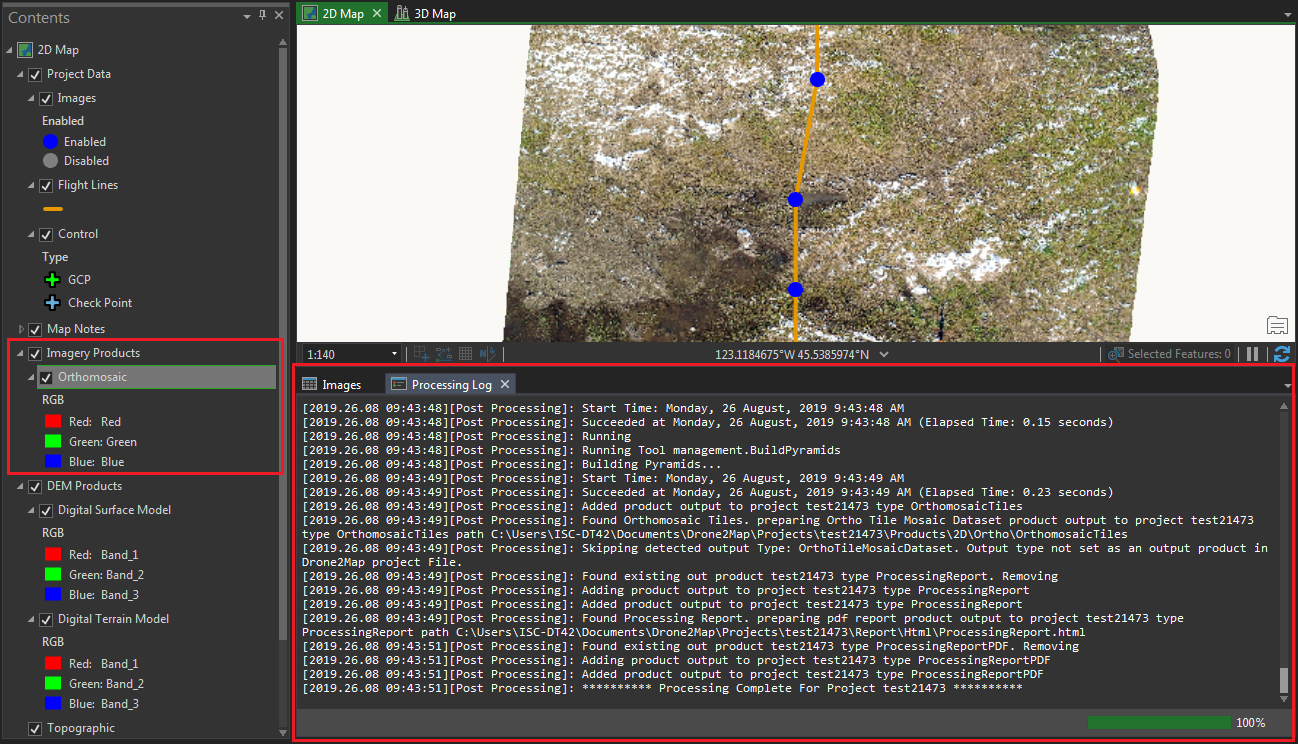

The image below shows the orthomosaic successfully created in the Drone2Map for ArcGIS application.
An orthomosaic is successfully created in Drone2Map for ArcGIS
