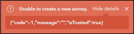

Attempts to create a new survey in Survey123 for ArcGIS using ArcGIS Enterprise credentials return the following error message:
Error:
Unable to create a new survey. {"code":-1,"message":"","isTrusted":true}
Error message

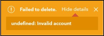

Further attempts to delete the item fail, and return the following error message:
Error:
Failed to delete. undefined: Invalid account
Error message.
