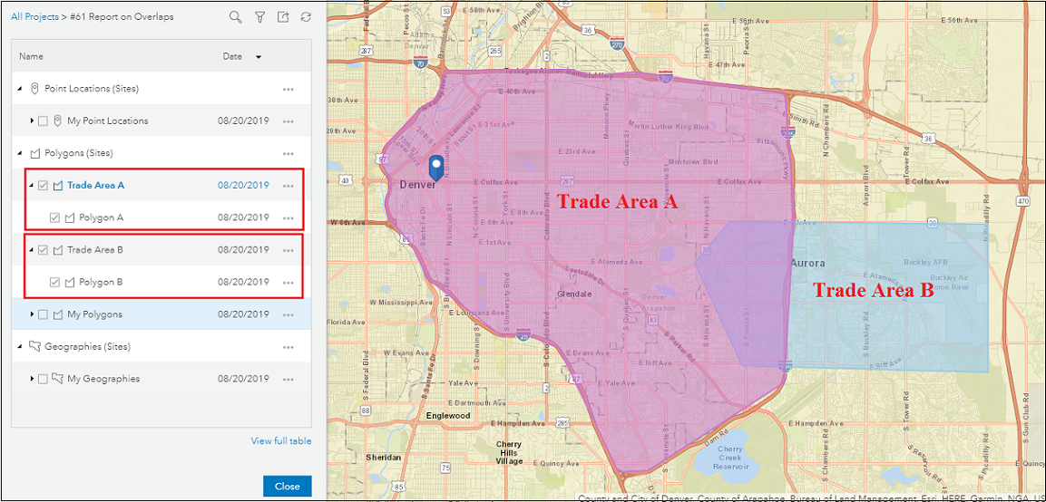

  2. In the current project pane, select the polygons to display on the map.
    The image below shows two polygons, Trade Area A and Trade Area B, and where a portion of the polygons overlaps.
Two polygons with an overlap

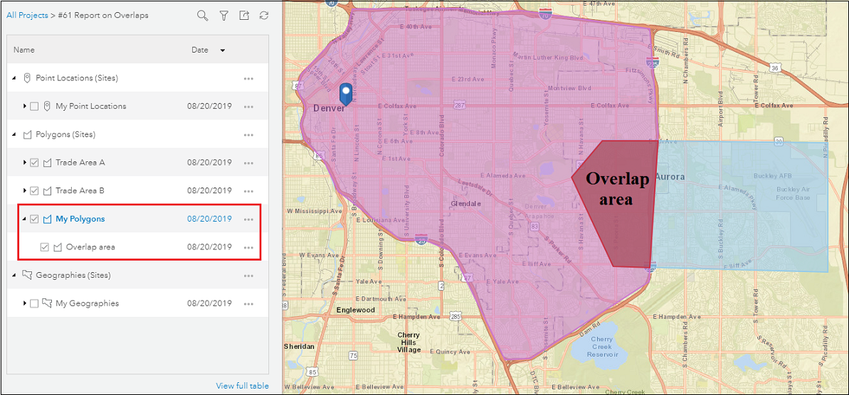

  1. Define the overlap by drawing a polygon to enclose the overlapping area.
    The image below shows the new polygon of the overlap area. The overlap polygon is named Overlap area, which can be found under the My Polygons layer.
This is the overlap area

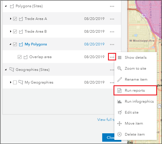

  1. Click the ellipsis icon of the overlap polygon and select Run reports.
Click Run reports

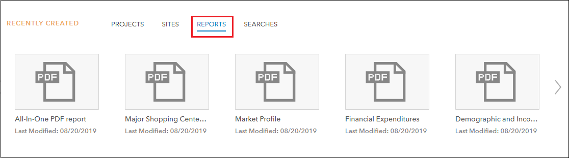

The downloaded reports are available in the REPORTS section of the Home tab.
All the reports downloaded
