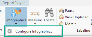

If encountered, this issue can be bypassed by the following steps to select the country to run Infographics within from the Configure Infographics window.
  1. Click the Infographics drop-down and select Configure Infographics.
  1. In the Show available data for drop-down, select the country to click within to return data, using the Infographics cursor.
  1. Click OK to close the Configure Infographics window.
    Upon completion of these steps, Infographics templates are returned populated with data for the feature clicked within the country assigned in Configure Infographics.
