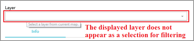

The image below does not show any layer when configuring the Filter widget, although the imported data from the CSV file are displayed on the map.
No layer available for filtering

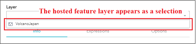

The image below shows the hosted feature layer is displayed as a layer selection in the Filter widget after the CSV file is published.
The hosted feature layer appears as a selection
