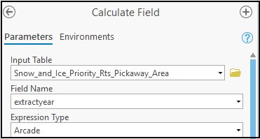

    1. In the Calculate Field window, click Parameters.
    2. In Input Table, select the layer with the attribute table containing the date field.
    3. In Field Name, select the newly created field from step 1.
    4. In Expression Type, select Arcade.
Calculate field window

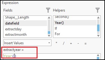

  1. Under Helpers, double-click the portion of the date field to be extracted: Year(), Month(), or Day().
  2. In the box under the new field selected in step 3c, place the cursor in the middle of the brackets of the selected Helper function as shown in the example below.
Year function screenshot
  1. Under Fields, double-click the date field containing the desired date portion. The following shows the created Arcade expression:
<DATE_PORTION>($feature.<DATE_FIELD>)
Date field inserted in the Year function.

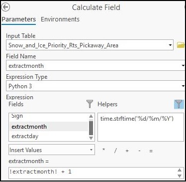

  1. Use a Python expression to change the month values range to 1-12 using the Calculate Field tool.
    1. In Input Table, select the layer with the attribute table that contains the extracted month field in step 3.
    2. In Field Name, select the extracted month field, the output of the Arcade expression from step 3.
    3. In Expression Type, select Python 3.
    4. In the box under the selected field name in step 4b, insert the following syntax:
!<FIELD_NAME>! + 1

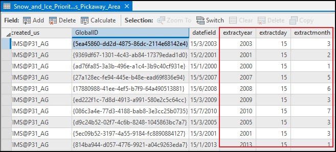

The image below shows the year, month, day portion extracted and inserted in new fields.
Attribute table with extracted date portion
