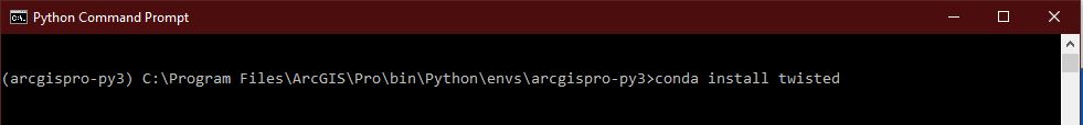

The packages can be installed using the Python Command Prompt. Run the following command to install the selected packages individually.
conda install <package name>
Note: Some of the packages may have been installed during the ArcGIS API for Python installation. To check the installed packages, refer to ArcGIS Pro: Python Package Manager.
