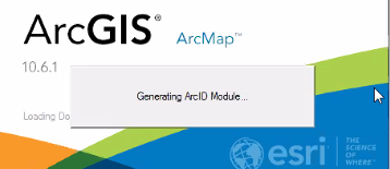

Upon launching ArcMap, a pop-up appears displaying the message 'Generating ArcID Module' and ArcMap closes unexpectedly.
