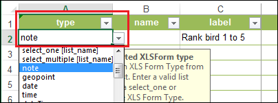

  2. In the XLSform, use note as a question type to display a note on the screen and fill in the label field.
Use note as a question type

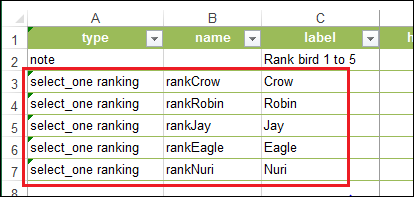

  1. Use select_one as a question type and fill in the name and label field.

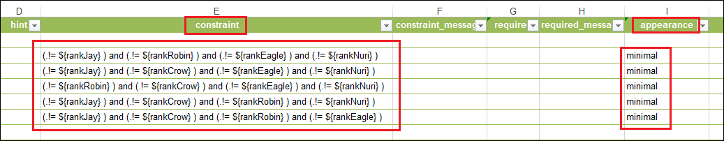

  1. In the constraint field enter the following expression for each row:
(.!= ${rankJay} ) and (.!= ${rankRobin} ) and (.!= ${rankEagle} ) and (.!= ${rankNuri} )
Note:
For the expression, depending on each row, do not include the same name as in the label field. Enter other names to rank the question.
  1. In the appearance field, select minimal from the drop-down list for each row.
Enter an expression for each row

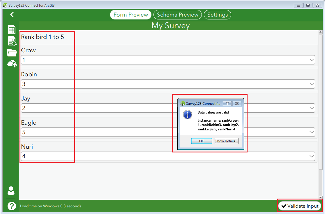

In the Form Preview of the Survey123 Connect for ArcGIS application, complete the survey by ranking the types of birds. Click Validate Input to validate the result. For more information, refer to Survey123 for ArcGIS: Data validation.
Click the Validate Input button to validate the result
