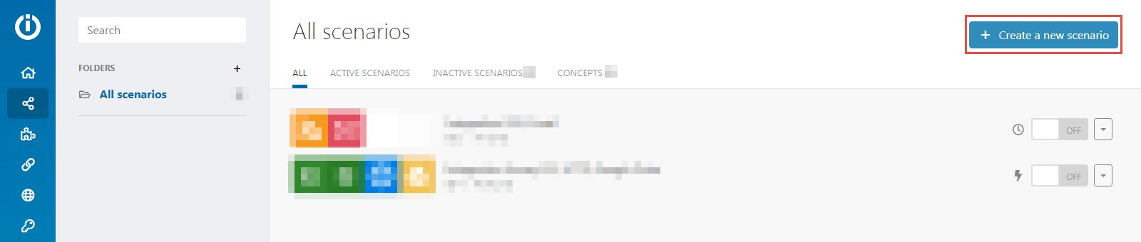

- At the top-right corner, click Create a new scenario.

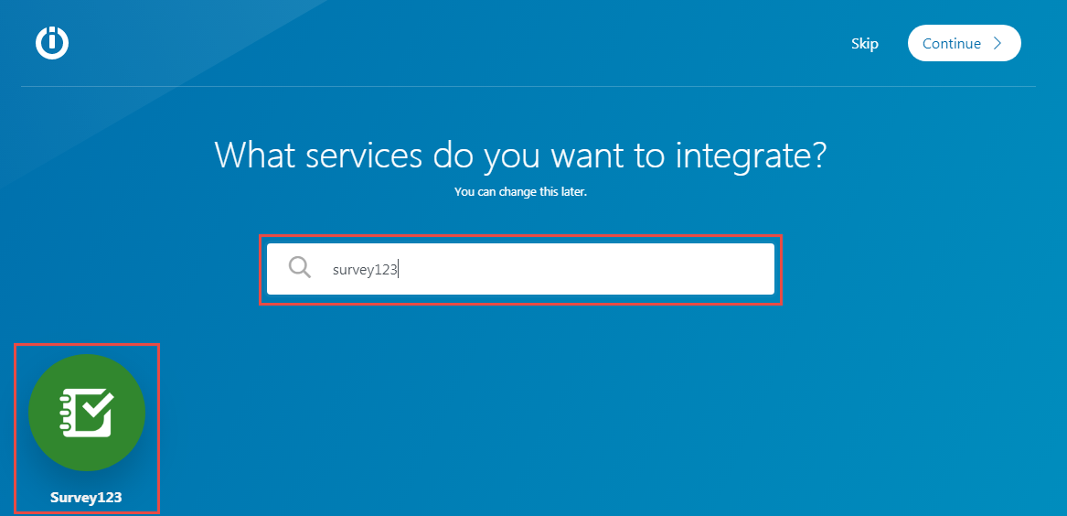

- Search for Survey123 in the Search box, click on the icon, and click Continue.

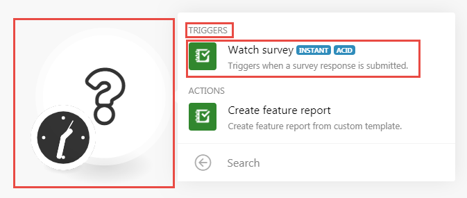

icon to select a module. Click Survey123 > Watch survey.

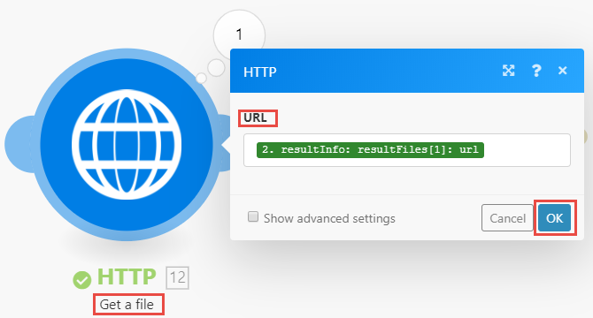

- In the pop-up, search HTTP, and click HTTP > Get a file.
Note: Use Get a file to download a file from a URL. This function directs the URL from the report output to download the report successfully.
- Specify a URL for the output of the Survey123 report. The following URL directs to the file in ArcGIS Survey123 of the last run report:
2. resultInfo: resultFiles[1]: url
- Click OK.

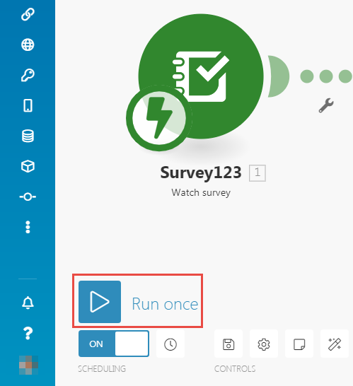

- Click Run once. This automation monitors the specified survey for new responses, generates a feature report for every new feature, downloads the report file, and uploads the report file to the desired location (Google Drive).
Note: Turn on SCHEDULING to record survey responses within a desired time frame.
