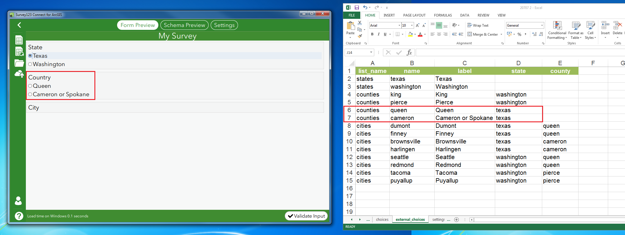

The following image shows only a single choice field displayed in Survey123 Connect for ArcGIS although there is another choice in the label field.
only a single choice field is displayed in Survey123 Connect for ArcGIS although there is another choice in the label field.

If there are commas in the choice list (label field) of the external selects worksheet, the choices are not displayed in Survey123 Connect for ArcGIS or when the survey is published to ArcGIS Online. This is because all the values from the external selects worksheet are saved in a file called itemsets.csv in the media folder of the survey project, where it translates the values to a comma-separated list. For more information, refer to Survey123 for ArcGIS: External selects.

To ensure all choices are displayed in Survey123 Connect for ArcGIS, remove the commas from the label field in the external selects worksheet. Then, click Save to save the survey form.
The image bellow shows all the choices are now displayed in the survey after the comma is removed from the label field.
All choices are now displayed in the survey after comma is removed from the label field.
