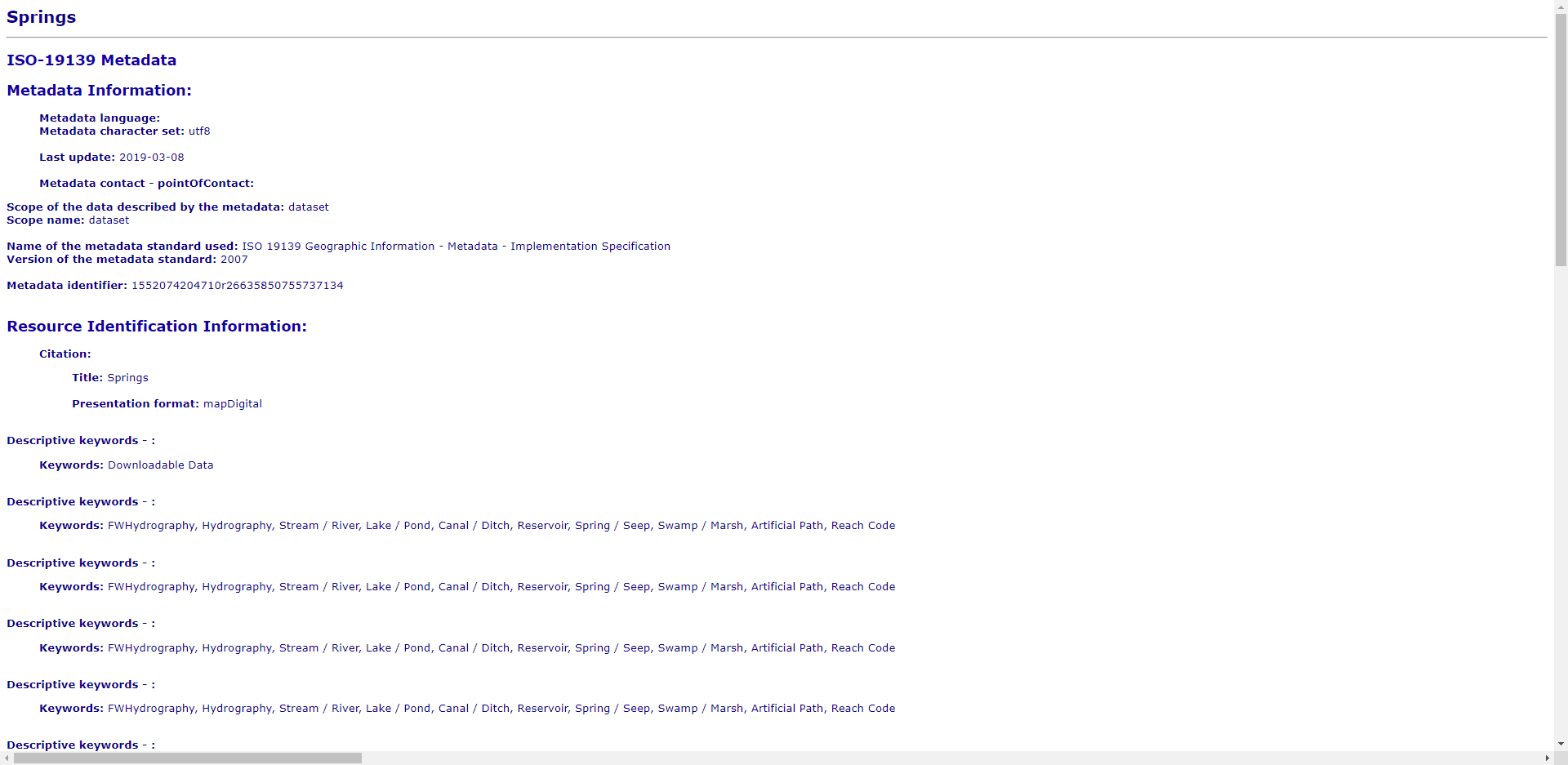

Feature Class Item Description
image of Feature Class Item Description

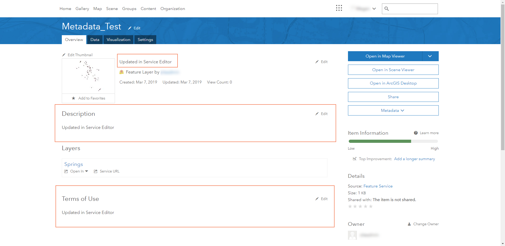

  1. Publish to Portal for ArcGIS with Mapping/KML/Feature Access capabilities. The Service Editor item descriptions was edited as Updated in Service Editor to show where the information came from when publishing.
After publishing we can see that information provided comes from the service editor updates.

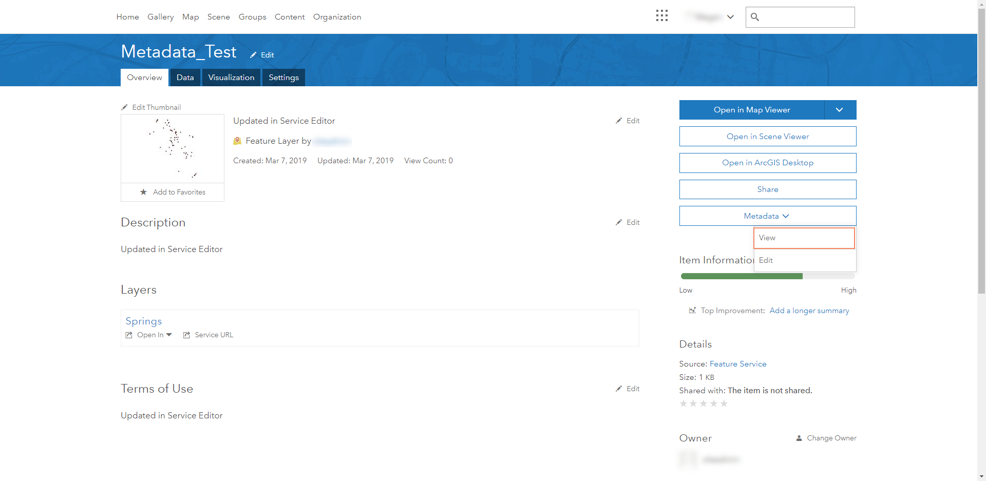

Viewing the metadata from the item details page by selecting View.
Shows that only the Service editor description updates persisted through publishing.

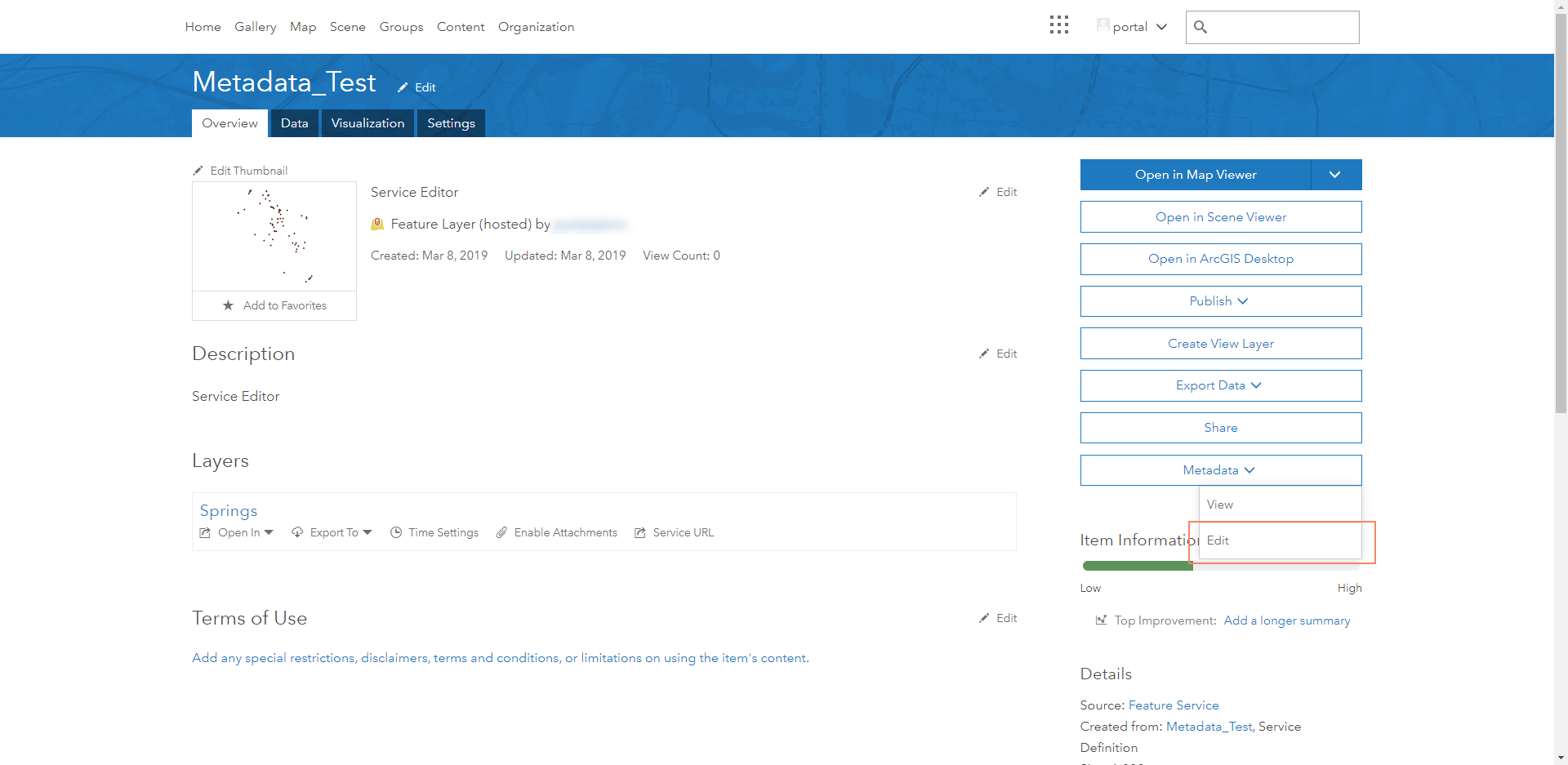

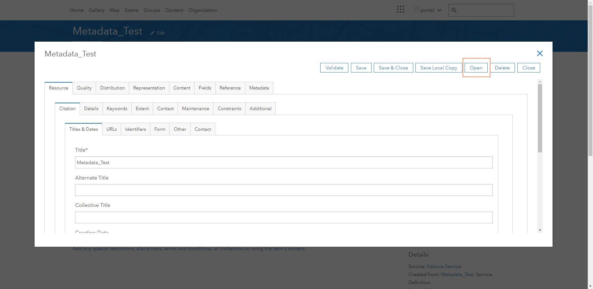

In Portal for ArcGIS, accessing the feature service or hosted feature service item details, select Edit from the Metadata drop-down.
Select the Open option and navigate to the xml file created by the XSLT Transformation tool. The metadata is updated based on the item details created in the original file geodatabase feature class description.

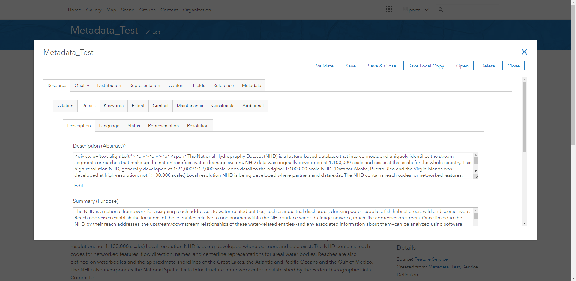

The metadata has been updated.

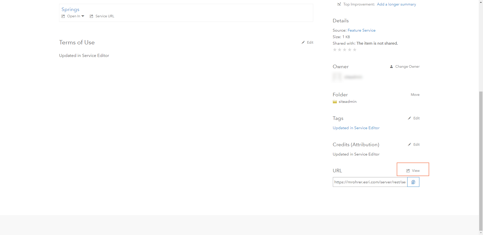

Feature service or hosted feature service item details have been updated as well (with a refresh of webpage).
