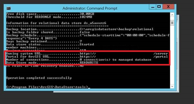

  6. Confirm the information is present in the following order:
    1. The owning system URL: the URL of the GIS Server site to which the data store is registered to.
    2. The Portal for ArcGIS URL: must be the URL of the portal using the GIS Server site as its hosting server.
    3. The data store mode is set to READWRITE.
The Utility Command data store information
