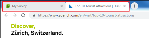

Clicking the hyperlink configured with the target="_blank" attribute opens the website on a new tab.
The webpage opens on a different tab
