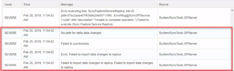

Attempts to sync Collector for ArcGIS with an Oracle database fail, returning the following error message:
Error: Error executing tool. SyncFeatureServiceReplica Job ID:<job_id>. ErrorMsg@SyncGPService: {"code":400,"description","Unable to complete operation."} Failed to execute (Sync Feature Service Replica)
In addition, the server logs further indicate the following error messages:
- No path for delta data changes.
- Failed to synchronize.
- Error: Failed to import data changes to replica.
