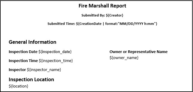

Below is a sample of a feature report template in a Microsoft Word file with the correct syntax.
Feature Report sample in a Word document
