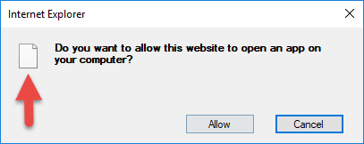

Navigating to the Survey123 for ArcGIS URL returns the message, "Do you want to allow this website to open an app on your computer?"
Clicking Allow prompts the message, "You'll need a new app to open this ArcGIS-survey123."
Image of Internet Explorer prompt to allow website to run app
