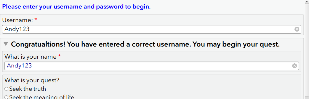

In the Survey123 for ArcGIS website or application, users with the permitted usernames can download and fill in the survey form.
Only the correct entries of the username have the permission to fill in the survey form

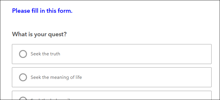

In the image below, the username question is hidden and not displayed when filling in the survey form in the Survey123 for ArcGIS website or application.
The username question is hidden and is not presented when filling up the survey form in the Survey123 for ArcGIS website or application

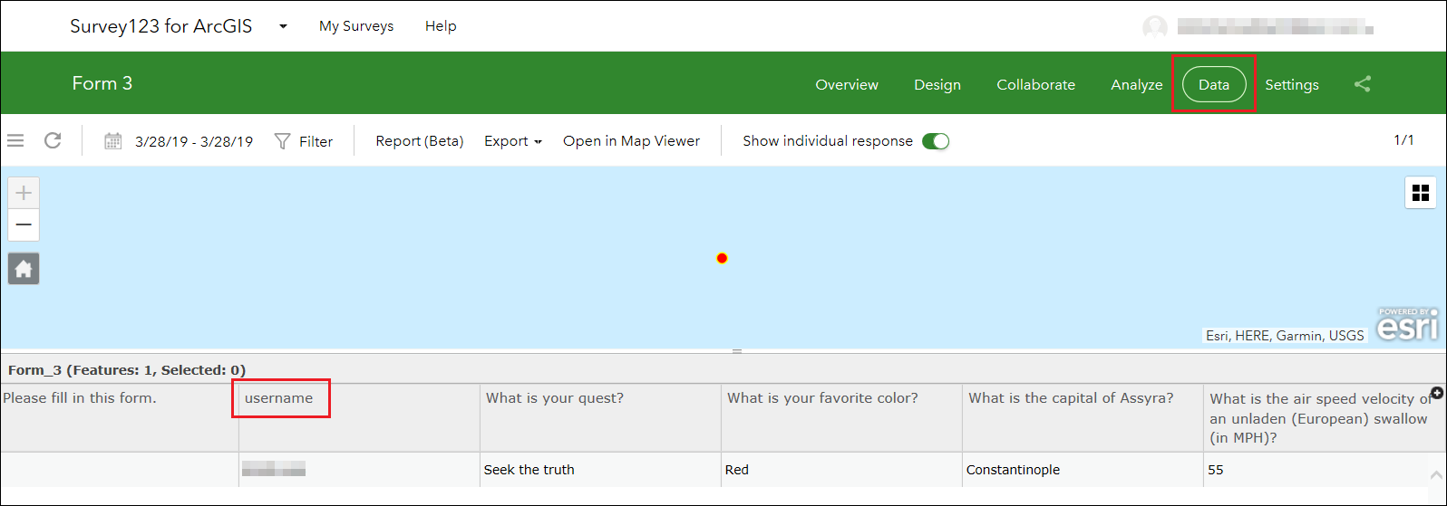

However, when viewing the data online, the credentials of the current user signed in to ArcGIS Online or ArcGIS Enterprise is recorded in Data where all the records collected from the survey is viewed.
The credential of the current user signed in either in ArcGIS Online or ArcGIS Enterprise is recorded in Data
