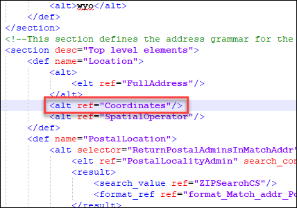

  1. Uncomment the line, change <!--<alt ref="Coordinates"/>--> to <alt ref="Coordinates"/>
Uncommand the line '{C}{C}{C}'
