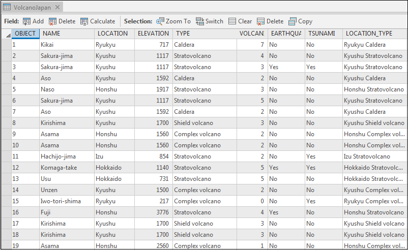

In some instances, a single layer has many attributes, which can be symbolized differently for better visual presentation. The image below shows a single layer of volcanoes in Japan (VolcanoJapan) that has multiple attributes, such as Location, Elevation, Type, and Volcanic Explosivity Index (VEI). In this article, two different attributes are symbolized using two types of symbology in ArcGIS Pro.
These are attributes information of a single layer.

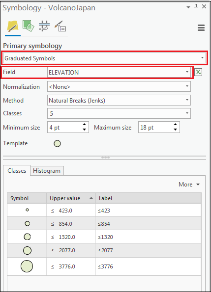

  1. In the ArcGIS Pro Contents pane, right-click the desired feature layer, and click Symbology.
  2. In the Symbology pane, click the Primary symbology tab This is the Primary symbology icon.. Specify the symbology type and the first field to symbolize. For more information on symbology types in ArcGIS Pro, refer to ArcGIS Pro: Symbolize feature layers. The image below shows the ELEVATION field is symbolized using Graduated Symbols.
This is the Symbology pane.

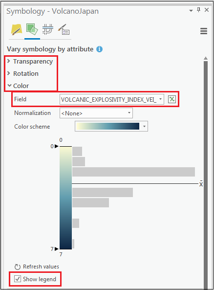

  1. Click the Vary symbology by attribute tab This is the Vary symbology by attribute tab.. For more information, refer to ArcGIS Pro: Attribute-driven symbology.
    1. Specify the symbology type.
Note:
In this workflow, the visual variable is limited to Transparency, Rotation, and Color variations.
  1. Specify the second field to symbolize.
  2. Check the Show legend check box to display the visual variable applied to the second field in the Contents and Legend panes.
The image below shows the VOLCANIC EXPLOSIVITY INDEX field is symbolized to unclassified color symbology.
This is the Vary by attribute tab.

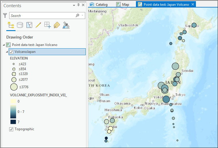

The image below shows the same layer (VolcanoJapan) is symbolized using two types of symbology (graduated symbols and unclassed colors) to represent two different attributes (Elevation and VOLCANIC EXPLOSIVITY INDEX).
This is the output of representing a single layer with two types of symbology.
