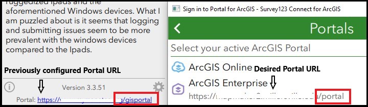

Selecting an ArcGIS Online or a different ArcGIS Enterprise portal as the active ArcGIS Portal in ArcGIS Survey123 Connect redirects users to the login page of the previously connected ArcGIS Enterprise portal. The selected portal URL does not overwrite the previously configured URL, as shown in the image below.

ArcGIS Survey123 Connect references the previously configured portal URL in the JSON file settings. The existing portal URL is not overwritten in the JSON file even after deleting and adding a new portal URL in ArcGIS Survey123 Connect.
