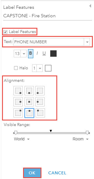

  1. In the Labels Features pane, for the Text box, select the first desired label to display on the map, and select the alignment. Click OK.
Note:
Verify the Label Features check box is checked.
Image of the Label features pane

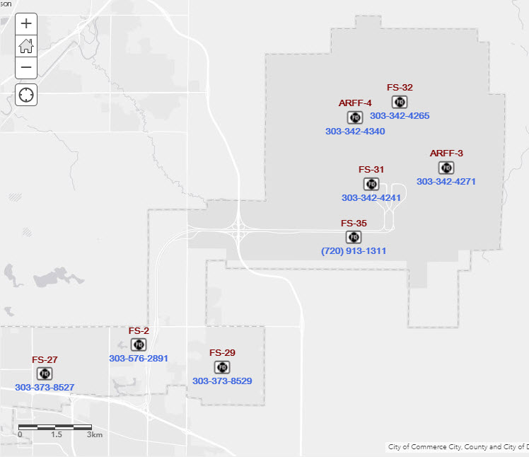

The image below shows the multiline labels for the point feature layer.
Image of the multiline labels for point feature layer
