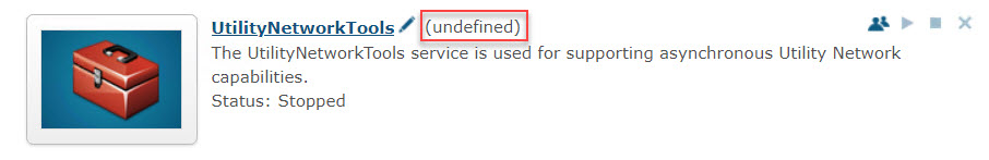

System services in ArcGIS Server display as 'undefined' instead of 'Geoprocessing Service' after the service name. This indicates the service is broken. Examples of a broken and working services are presented in the images below:
Example of a broken service:
Image of a broken service showing as 'undefined'

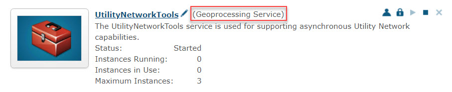

Example of a working service:
Image of a working service
Workflows associated with the service fail indefinitely. For example, publishing fails if PublishingTools or PublishingToolsEx services display as 'undefined'.

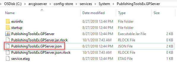

  1. Obtain a new JSON file for the corrupted service. Copy the JSON file from the associated service in a working environment.
Default location: <Install location>\arcgisserver\config-store\services\System\<service name>\<service name>.GPServer.json
Image of the location of a service in Windows File Explorer

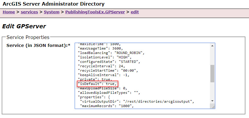

  1. Scroll to the bottom and click edit.
  2. Search for the following parameter:
"isDefault": true,
Image of the Service Properties textbox
  1. Change the value of the parameter from true to false. Click Save.
Note:
Changing the "isDefault" parameter to false allows the service to be deleted. If the parameter is unchanged, the system service cannot be deleted.

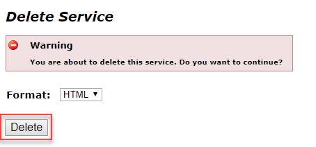

  1. Navigate back to the service endpoint in ArcGIS Server Admin Directory. Scroll to the bottom and click delete.
Image of the delete option in the service endpoint
  1. Click Delete when prompted.
