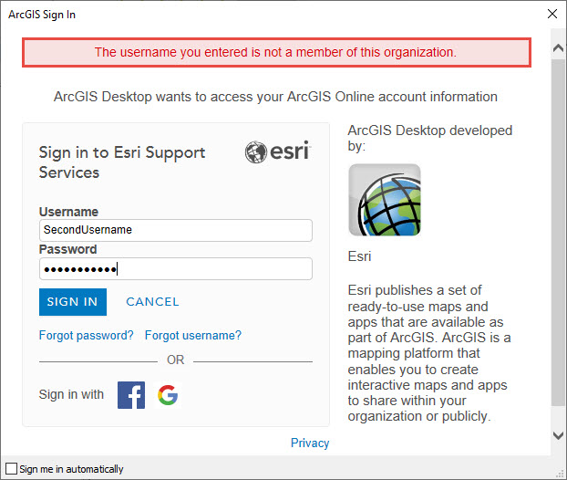

The image below shows the error message displayed when attempting to log in to ArcGIS Online from ArcMap.
Error message displayed when attempting to log into ArcGIS Online from ArcMap

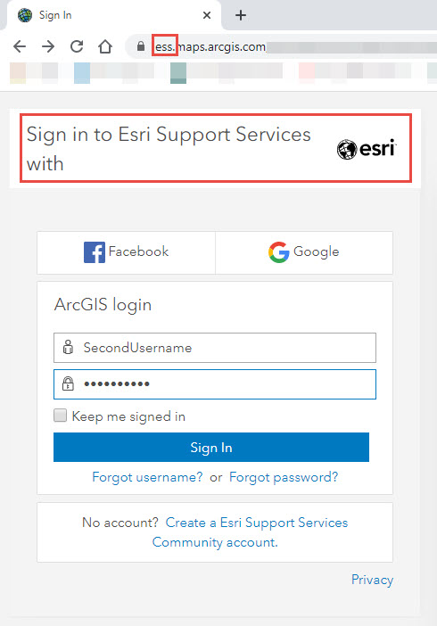

  • This issue occurs when a user attempts to log in as soon as a user from a different organization has logged out from the sign in page. The URL of the sign in page contains the short URL of the previous organization logged in. ArcGIS Online assumes the second username belongs to the same organization.
The image below shows the short URL and the organization's name on the sign in page after a user has logged out.
Indicators of previous organization
