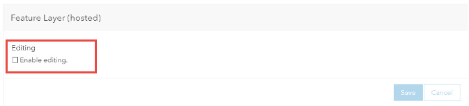

However, after creating and running the GeoEvent service, the hosted feature layers created from the data in the Spatiotemporal Big Data Store do not have editing options available when opened in ArcGIS Server or Portal for ArcGIS. Only the URL of the hosted feature layers from the services are displayed as shown in the image below:
Editing option disabled
Generally, ArcGIS Server or Portal for ArcGIS has the option to enable or disable editing for hosted feature layers as displayed in the image below:
Editing options
