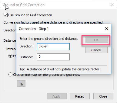

When working with a parcel fabric, attempting to manually enter a ground direction offset value using DMS (Degrees Minutes Seconds) units in the 'Ground to Grid Correction' tool from the COGO toolbar fails. The 'OK' button in the 'Correction - Step 1' dialog box is unavailable.
The directional units defined do not match the units of the current input. For example, if the directional units are defined as Decimal Degrees (DD), but the user input for ground to grid correction is in DMS, the correction cannot be applied. For more information, refer to ArcGIS Help: Using the Ground to Grid Correction dialog box.
